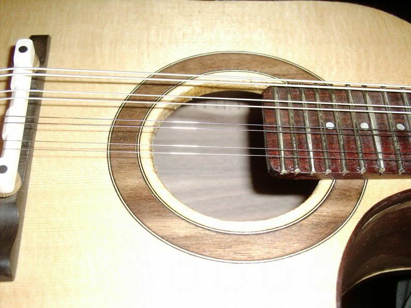

PostPosted: Thu Mar 15, 2007 12:35 pm
I've done three the same as Paul's method and Like Lance and Terry mention, seal the channel with thinned lacquer or shellac before using CA.
Also, since we are showing our rosette's I'll do the same.

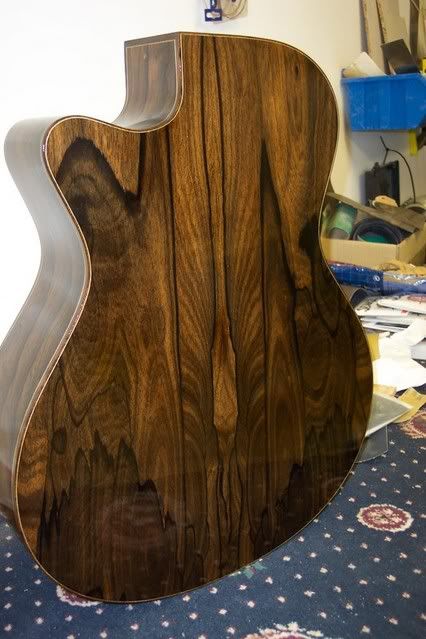

PostPosted: Fri Mar 16, 2007 8:06 am
Thanks Hesh, yours is great looking too, I like the matching bound fb.
Roger, rabbit granules......now that sounds interesting. Glad you didn't say pellets
PostPosted: Fri Mar 16, 2007 6:36 pm
Joined: Thu Feb 02, 2006 9:36 am
Posts: 24
Thanks Hesh but look at the back////////
